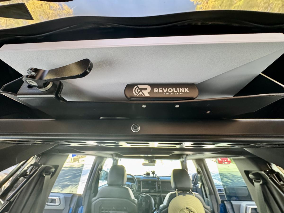

    Any pics after the install?
    • JoergH
      • 257
      One of the things I like about it is that it's mounted up pretty high and hard to see with the top on. Right now she's at Ford getting her 20K service done, but when she comes back I'll see what I can do.
      • JoergH
        • 257
        OK< you can't see it from outside the vehicle at all. From the inside, it's also pretty hard to see from the drivers seat, etc. So I held the camera up close from the back with the top open and the back seat, and here's what I got...
          Barely notice it there. If it was black, you wouldn’t notice it at all.
          • JoergH
            • 257
            And I had to hold my phone up in there to get to it. From the outside it’s pretty hard to see.
